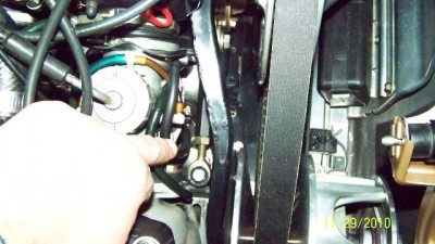

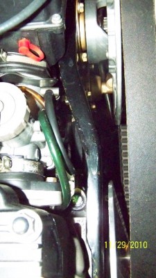

Simply measure and drill the hole ?

MAPEX wrote:If I'm not mistaken, the torque bolt should go in front of the motor, in between the exhast pipes where they exit the cyliders. There should be a place to slide the rod through on the front engine mount on the crossframe and the other end should, through that hole, push through and hook around the rear section of that mount, the piece connected to the case, and then should hold the motor in place when load applied. That probably makes no sense at all and if not just say and I'll try and clean it up a bit.
Yes, most Torque arms I have seen were mounted in the front altough, front or rear from the frame to the engine mount would have the same effect ? Back when I bought my kit from Reichards, I believe (if memory serves me correct....) they said there was no good way/room to fit it in the front so, they designed it for the rear engine mount.
