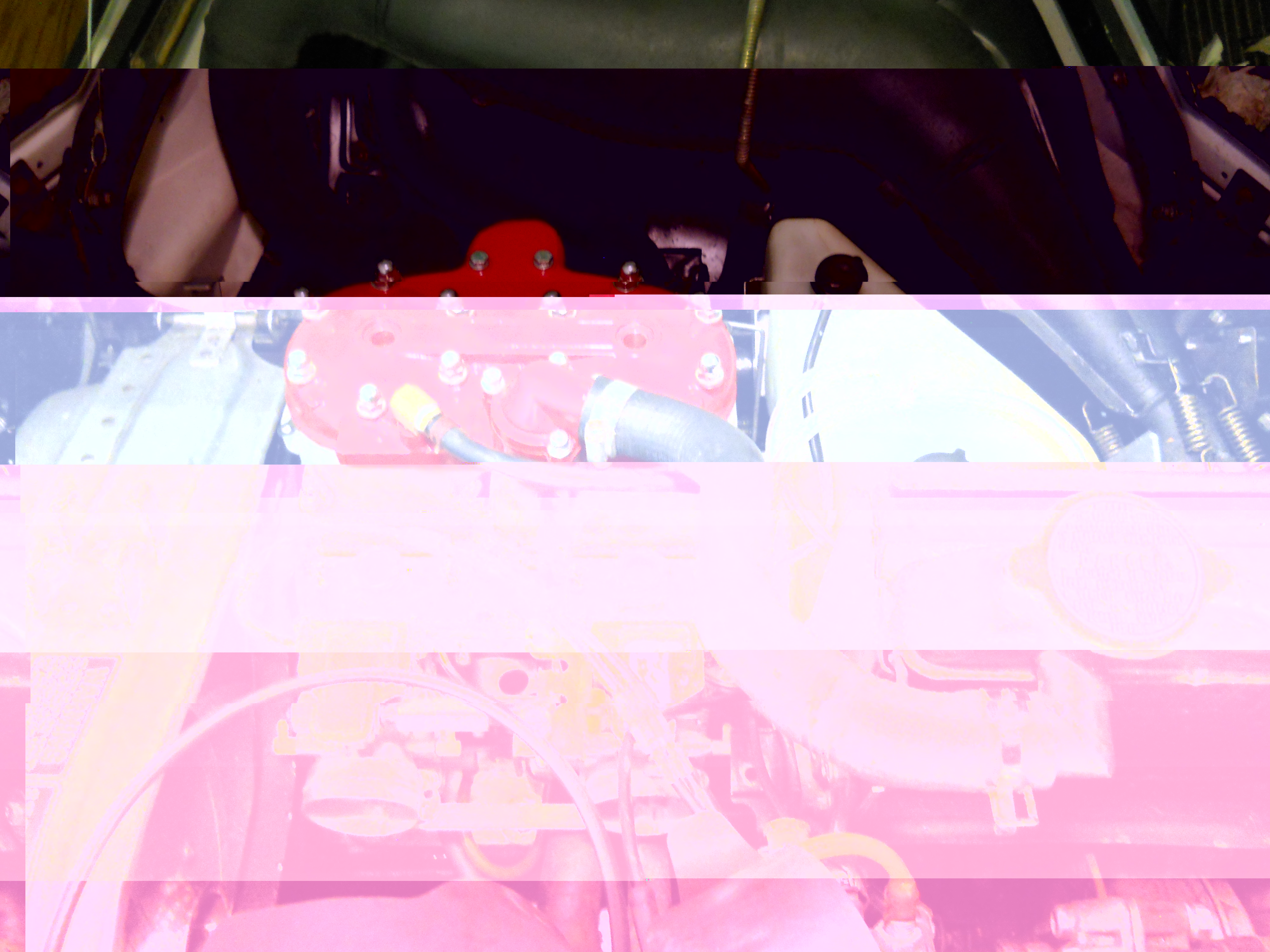

Finished up the engine and installed it into the sled this weekend. Just need to get a throttle cable and widen the boost bottle. Looks like i will have to use K&N filters as there isn't room for the air box. Will find a new mounting place for the coil as well. Planing on firing it up this coming weekend. Getting excited about getting it running. I will try and get an air box to work, but for now I will run filters.

Got in running this weekend. Started right up and no problems so far. Can't wait to get it on the snow. Check out the video.https://youtu.be/dVK_j1gzgPM
