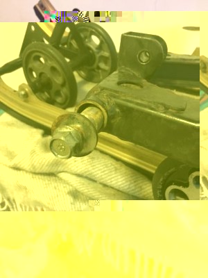

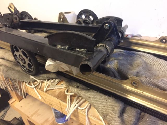

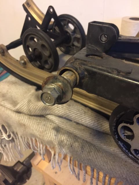

What bushing is supposed to be on the pivot arms?
There is some slop without any bushing.

Posts: 659
Re: 86 Vmax Resto
Sorry, I got Pol. extra 10's in mine. Should be easy enough to turn up on a lathe if you can't find them

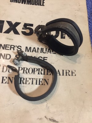

Where is this band supposed to be?

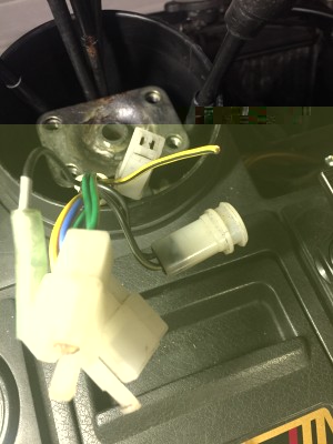

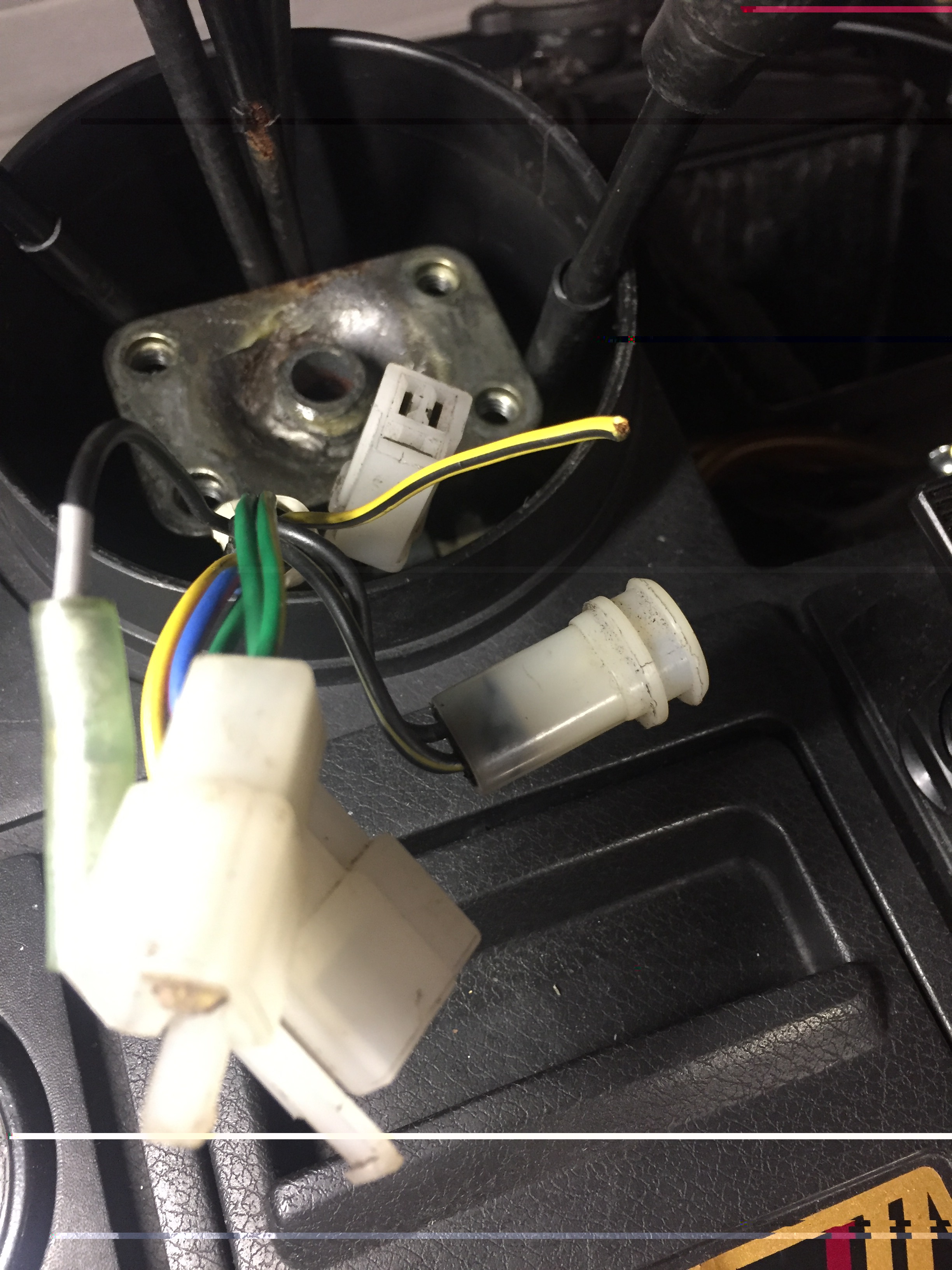

Unsure about the wiring for the hand warmers. There is a yellow/black and a black wire coming from the wire harness. The hand warmers connectors are all black.
Any suggestion how this is supposed to be connected?

This forum seems very dead... But i found out through my pictures the rubber bands are for the external gas sylinder on the skid shock.
The yellow/black wire is for left hand warmer.
Re: 86 Vmax Resto
viewtopic.php?f=2&t=1529 Look at (-handwarmer installation)
