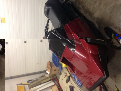

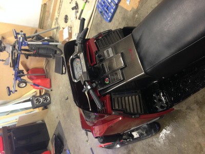

Looks nice. Sorry I can't help you with a set up for what you have, my engine is not stock. What I will say is if your buying new, most of my sleds have always had Comet 102 or 108. When I finished the new engine for the V Max last year I used a Polaris p85. So far so good, but I was sick and tired of bushings being beat out of the Comets in a season
