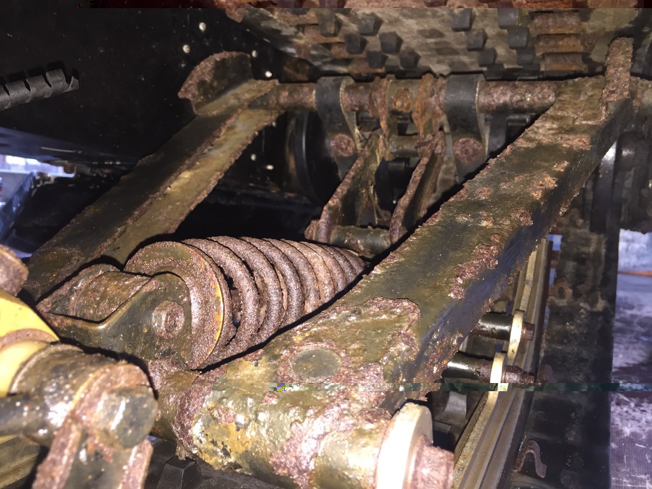

New member here and bought a 86 Vmax 540 just recently. The rust has got a bite on it, but seems like the frame is quite good.
Haven't got further than to cleaning yet, but it will need new boggie, track, engine rebuild and other refreshment.
Are the other pro action boggies the same width as the original for Vmax 540? Exciter, SRV, Vmax 500/600... Or is the Vmax 540 tunnel too narrow for those?

Anyone who have put a boggie from a 1998 or newer SRX into a Vmax?
Wondering how that would work.
Re: 86 Vmax Resto
Not sure on newer Yami stuff. I put a Pol. xtra 10 in mine, very happy easy to find because their were so many, watch for one with Fox shocks, their rebuildable and good. Also put on in my SRV, almost a bolt in swap. There are articles showing the new bolt locations of people will post them. Search here and the  540 SRV site been done lots of times. Look around, I paid just under 100 bucks both times

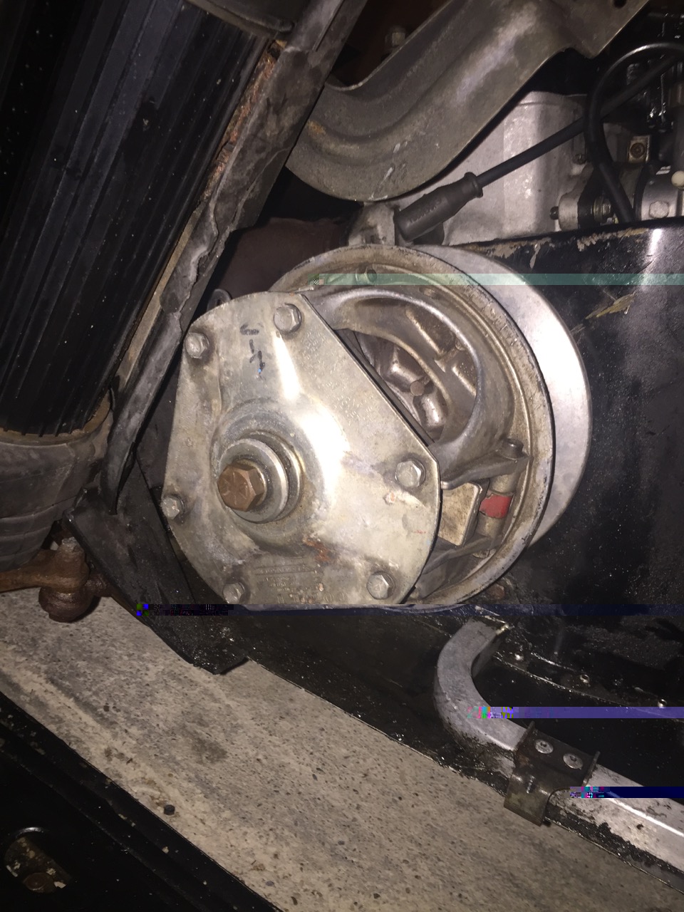

Hi Mathis. Looks like original clutch. Yamaha had comet primary clutch as default on this sleds. Around me, there is alot of companies that perform powdercoating. Are you member of norwegian facebook page snøscooter veteran og klassikere? Here you will find alot of other people with same interest.
						Re: 86 Vmax Resto
Looks like a 108c on the primary, originally came with a 102c the 108 is a replacement clutch. Great find non the less..

hmm, have to get those clutches off to see if there are any id stamps on it.
The T.S.S. are stuck, probably rusted. Haven't got to look more closely at those. But will need to rebuild the shocks if possible.
Or aren't there any parts available anymore?
Re: 86 Vmax Resto
Often its the knee action on the struts that freezes up. Sometime soaking and working the  bolts will do it, often it takes heat. I have drilled out reamed them for a larger size bushing and started over but it solved the problem

Can't help with bearings but front and rear suspension components are shared with SRV's of the same vintage.
