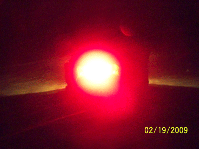

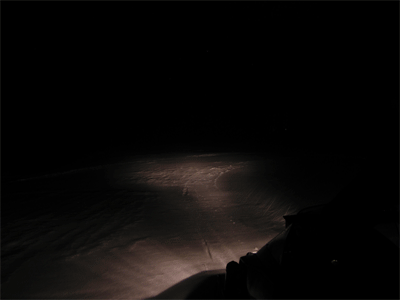

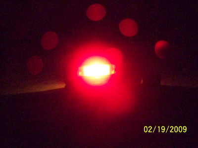

Unforunatly it turned out to be harder to take test pictures than I thought. Althoguht some of the pictures arent to clear we did manage to get 5 states:
Pictures range from Standard, to Cheap LED, to Expensive LED
|  This is at idle with no brakes |  tailight at idle (no brakes) |
|  at 5000 rpm with no brakes |  at idle with the brakes on |
|  at 5000 with the brakes on |
|  with the brakes on at 5000 rpm | |
The pictures might not accuratly show it but this is our verdict is:
  BOTH bulbs plugged right in and worked with no other modification. BOTH bulbs operated the brake light with out dimming the headlight! The cheaper of the two bulbs made the tail/ brake light worse in all states especially idle. The more expensive bulb did not change the tail light brightness for better or worse.
