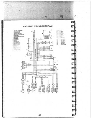

They looked great, I reintsalled them and pulled to start the motor and the rope broke.
I walked home(i was close) and then walked back to sled pulled recoil installed new rope and re installed the assembly.
Still wouldn't start.
Checked and found no spark and towed it home
After playing with some wires at he coil i magically had spark and drove it around and it ran strong as hell(skis up) and then died
I presumed it to be a faulty coil so i put a new coil on it.
No spark

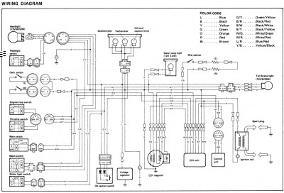

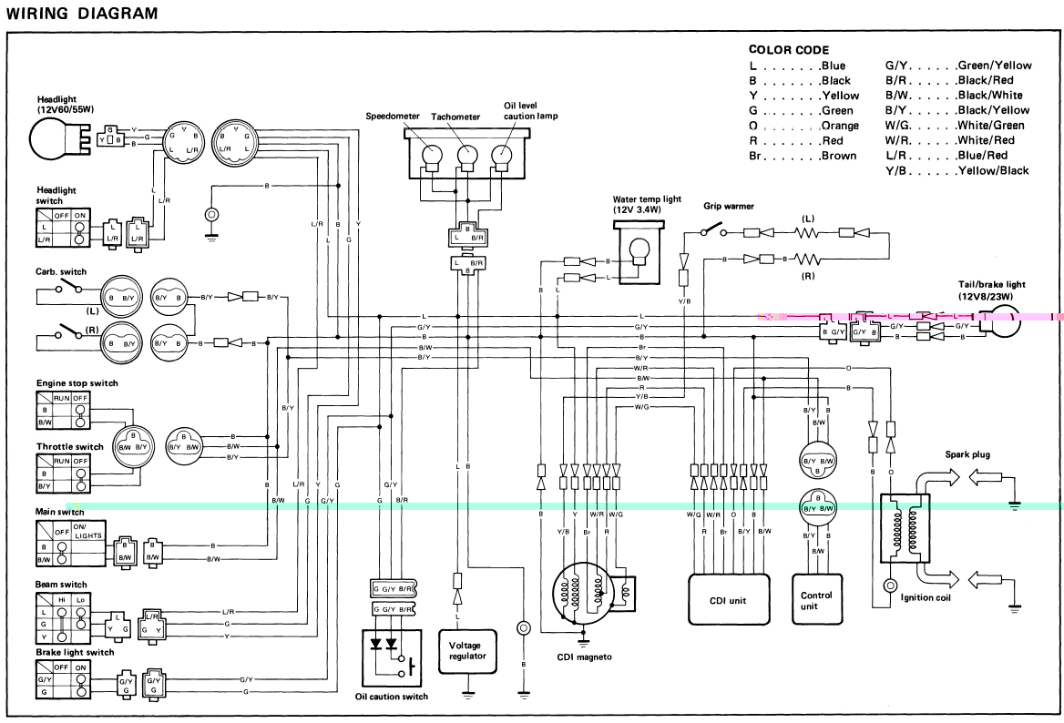

My CDI has 2 black wires pulled one at a time and both times no spark
Ohm checked the orange wire from coil location to cdi box and it was ok
Black wire good too...
Maybe i broke something in the flywheel starter area with the on and off
I know lighting is a different circuit but fir what its worth the headlight does illuminate as I pull start it
Should I pull recoil and then flywheel and check in there ?
Did I maybe wreck something?
I'm all out of ideas
HELP
