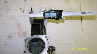

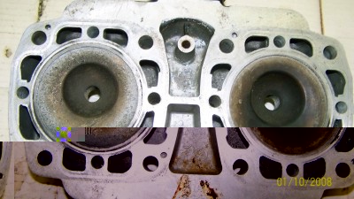

Measuring Heads here is what I found with six different 540 heads. Give me your thoughts, I know this is not cc'ing but would this not give you an idea on the head ?
5 measured between
37.33mm - 37.69mm
1.46in - 1.48in
1and15/32 - 1and31/64 in fractions

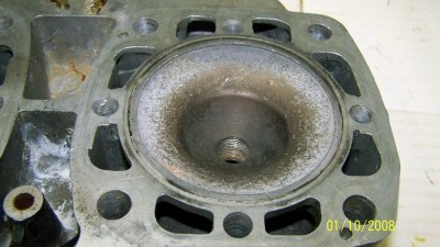

1 Measured (and has detonation or debri marks) Is this safe to run any thoughts ?
36.22mm
1.42in
1 and 27/64 in fractions
*Also one 1981 SRX440 Measured
36.91mm
1.45in
1 and 29/64 in fractions

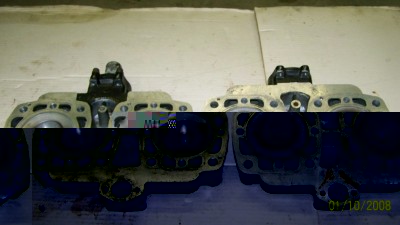

*The last picure shows the damaged and cut head on the right and a stock head on the left*

Chuck, I don't know what to say, I have never tried to measure that way. How consistant that method is would depend on how stable Yamahas casting was. I assume they cut in the chamber indexed off the head surface so how thick the casting is really wouldn't matter.
I know being a consultant for Briggs Motorsports Div. that each and every part has a low and a high tolarance limit on every part they make. All production engines have this. Its because of many things, variance in castings. Wear on the machines that cut the parts as they make thousands of them. The same with the tooling and how often they change it, and of course,especially back in the 80's there could be some human induced variance. ( commonly refered to as either the Monday mourning, or Friday afternoon part).
Again I don't know about Yami production technics but I would try this. Look for a flat machined area in the chamber, I don't have a head here, but maybe the spark plug hole has been back cut. Now use a flat bar. I use a 1/2 bar, long enough to span over the chamber. Now measure down with the stem of your caliper from the top on the flat bar to your flat surface. If you measure several, you should get a feel for how consistant Yamaha was, and/or be abel to tell if a head has been cut.
You also could try the old method of fishing in a lenght of solder threw the plug hole, then rolling the engine over to flatten the solder, this is used to check the distance between top of the piston and the edge of the squish band but besue you have the solder out to the end

In you pics the head on the right has been cut. You can tell but the fact that the black area by the T-stat is gone. All factory uncut heads will be like the head on the left in that area.
I wouldn't run the cut head on a stock engine without having it cleaned up and redomed to make sure it's right.
Most that you see cut like that were on a ported engine. When the exhaust ports are raised it needs to be done to bring compression back. How much depends on how much port work was done.

The head on the right is stock. The one on the left has been cut and redomed.
There are many reasons to do this including just repairing a head that has been damaged from a burn down. Raising intake/exhaust ports decreases the amount of compressable air space on the top of the piston so it can lower the compression (psi #). To bring it back up cutting the head which lowers the CC volume in the cylinder when compressed is common. There are limits to how far can be gone depending on many factors. The factory Yamaha specs are usually in a "safe" range and there is room to cut a head some without being in a danger range. Many variables on what to do and when to do it. I understand the pricipals and applications for such mods but don't do my own and don't have any specific numbers I could give you.
