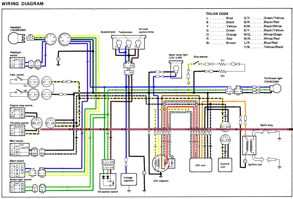

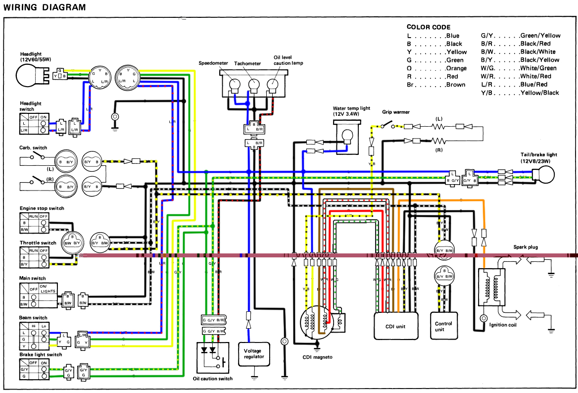

hey guys i did some photoshop work... hopefully this makes things a little easy to see... if someone could verify that i made the wires going into the "throttle switch" and the "engine stop switch" the right colors that would be great
Re: intermittent no spark (long story)
These are from the 83-84 manual I'll try and remember to get these from my 86 box tonight.
