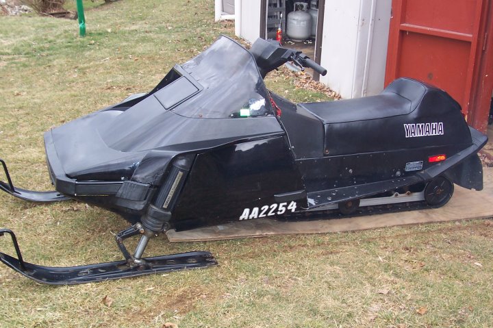

Has spark at the new plugs, compression and is getting fuel. It won't even fire with starting fluid in the jugs. Weird. Has always been reliable and fires on 2nd pull. After last thursday's storm and riding it bogged and stalled out. Fired back up and limped it into the garage.(bog). When I went to pull it the next day, the pull starter almost busted 2 fingers and was extremely difficult to pull. Pulls fine now. Checked PSI, 135+, changed plugs, good spark, getting fuel. I am baffled. Any thoughts would be appreciated.

I wonder if your stator moved and it is so far out of time that it won't fire with the current timing. I would check you timing marks. That may explain why you are still getting spark. It is just sparking at the wrong time.

yeah..ya'll think I'm crazy..fuel, air, spark and compression and NO start...I feel crazy
Re: 84 Vmax won't start
Thanks Donnie..I'll check the "timing marks" ...once I figure out how to do that
..I just figured ANY spark would fire the starting fluid...thanks for responding

Check your kill switch, key switch and wiring especially the connections on the right front bottom where they come out of the stator and hook to the wiring harness. This is a trouble spot in which the connectors tend to loosen and get oil soaked over time. Loads of posts on here about CDI's acting crazy but, not completely quitting ? Starting fluid unless, it has lubricant is not the best idea on a two stroke.

Thanks for the info Vmax 540. I will check those items although my kill switch was snapped off in the "on" position when I bought her 5yrs ago. I will check the connections. Yes, starting fluid is bad for 2 strokes, just a small amount to see if it would ignite. Thanks again

if the spark plugs are soaking wet after you pull it over more then likely it has fuel in the pipes and case, thats why it was so hard to pull over. I would pop off the pipes and tip them over if fuel runs out its case flooded and it will not start till you empty it out. If so, the needle and seat are leaking in the carbs or if its left sitting up on a jackstand that model sled likes to siphon the gas into the case.

this sled is flooded. use those fuel shut-offs like its part of your on and off switch. these sleds will flood easy and won,t start if case is flooded. 3:16 (yammie tony)

Thanks Yammie. YES, I use the fuel shut offs after each ride, as I do know this sled floods easily. 5 years now. I may have forgotten to shut them off that thursday night. So friday morning when I pulled it and she wouldn't pull, I figured it was full of gas. Plugs were soaked too. Pulls easily now. Gonna pull the pipes off and check that. Oddity though is the thursday night ride was awesome and ran great til the bog started at the end of the ride and had to limp her into the garage. So something started when she was running. Then no start. A bit more snow coming so, I'm on it tomorrow.YAMMIEGOD 3:16 wrote:this sled is flooded. use those fuel shut-offs like its part of your on and off switch. these sleds will flood easy and won,t start if case is flooded. 3:16 (yammie tony)

Good advice as well, much appreciated. Yes, plugs were soaked. Might have left the fuel shutoffs on. But it was only over night which usually isn't too much of a problem. Gonna pull the pipes. Thanks again.mrviper700 wrote:if the spark plugs are soaking wet after you pull it over more then likely it has fuel in the pipes and case, thats why it was so hard to pull over. I would pop off the pipes and tip them over if fuel runs out its case flooded and it will not start till you empty it out. If so, the needle and seat are leaking in the carbs or if its left sitting up on a jackstand that model sled likes to siphon the gas into the case.

lets hope its not electrical. you might have bad coil. lets address flooding first. 3:16 (yammie tony)

oh GOD(pun intended)...pray it's not electrical...that's where dumb(me)...becomes dumber(me x 2)
