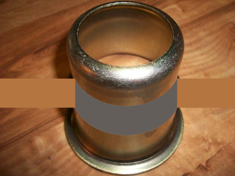

This is what i did to lower the front end of my 84 vmax. i found a piece of pipe that was the correct diameter and added like 3 inches in the center of the cup. This drops the spring and drops the front end. Sorry i don't remember exactly how much i added, and i have yet to test it in race mode.
I do know i added quite a bit of metal in between because my thoughts were, i could stack some big rings on it to change the amount of drop for tuning the chassis. Like i said, i have yet to make it that far.
