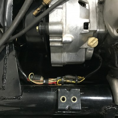

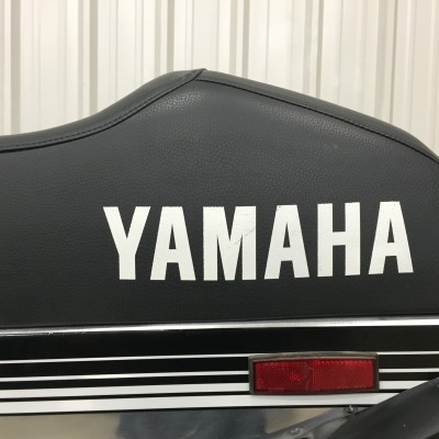

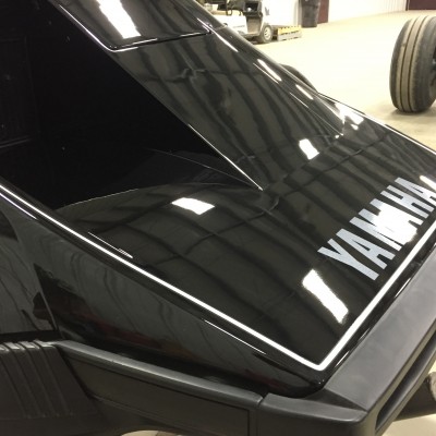

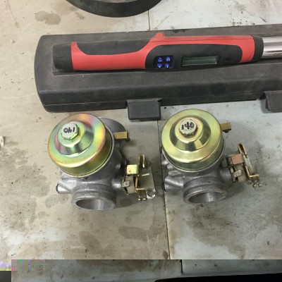

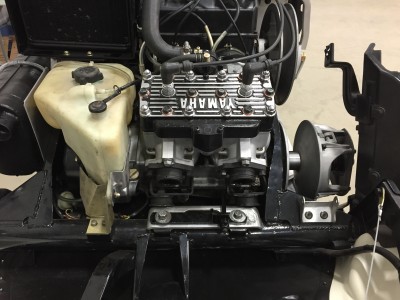

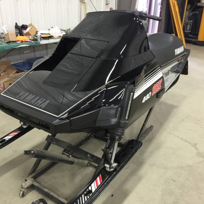

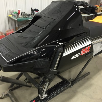

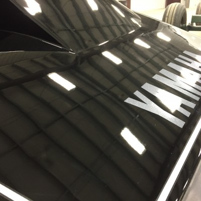

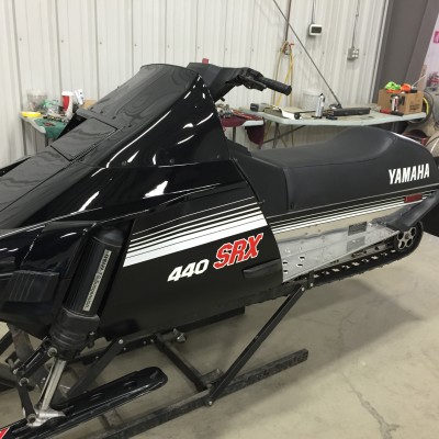

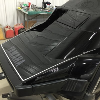

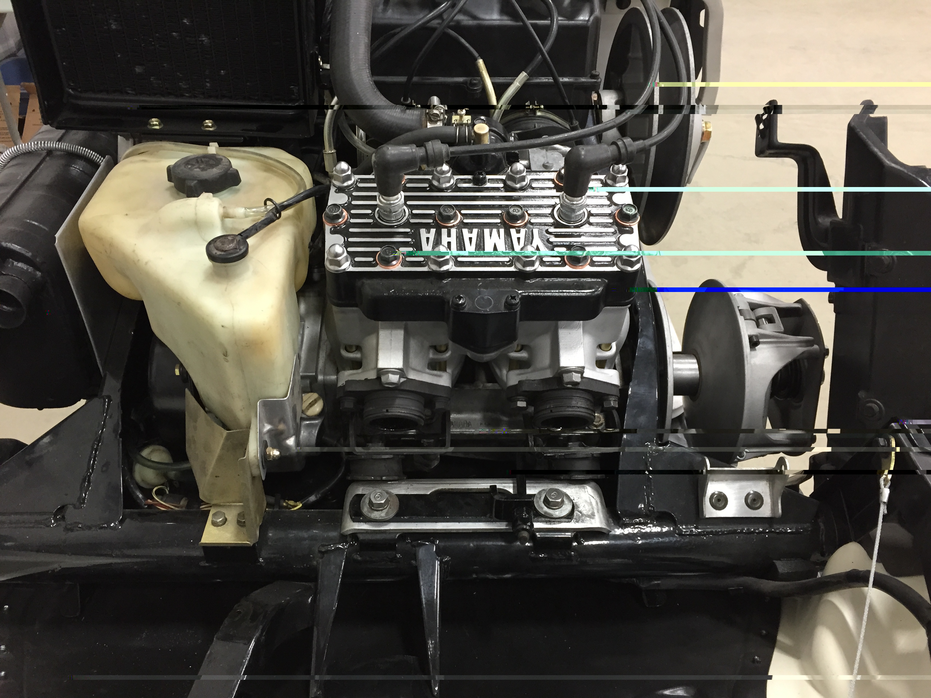

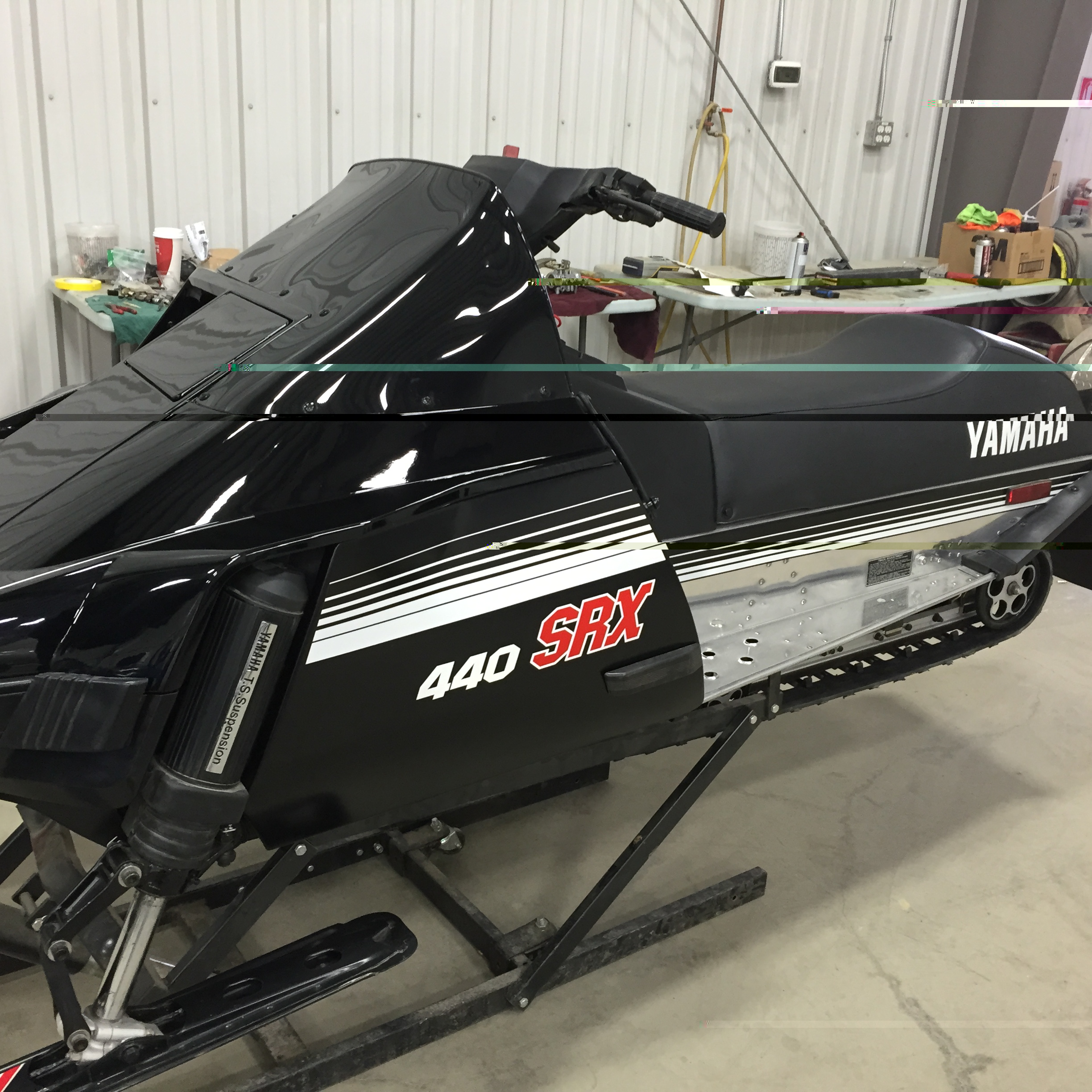

This 81 is completely done.Seems to run great.Compression is 150psi per side. Clutch engagement 5800. Yamaha comet with N1 46.4 gram weights with notch added.Comet stiff purple and two shims. Jetting stock.Now on to a 86 Vmax complete.

Very nice job. Great to see these sleds restored and kept running. Very nice!!!!
Re: 81 srx total rebuild part two
Wow, great detail ! I'll bet with that clutch setup and notches that will launch hard !
Nice machine! Any vids? Would love to see it running.
