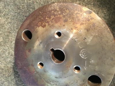

I picked up a good running 87 (83H) motor for my 83 Vmax project but the motor was in an 85 chassis with an 8U9 cdi. Is it safe to assume the stator and flywheel is 83-86? I can't find any Yamaha part numbers on either but there is a few stamped numbers letters so any
help here is appreciated. Thx
How to identify what year stator/flywheel help needed

Check the ohm reading with the RED & Red-White wires if it is a 84-86 it will have 10 ohm's if it is a 87 up it will have 50 ohms. Hope this helps you out..
Re: How to identify what year stator/flywheel help needed
I always wondered about the flywheel differences???
