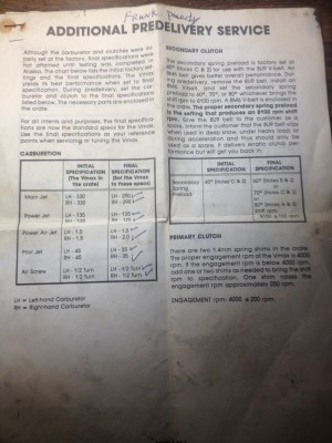

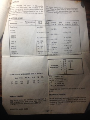

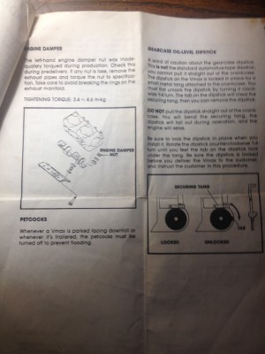

here is the dealer setup sheet that came with my 83 vmax I hope you can read them.
