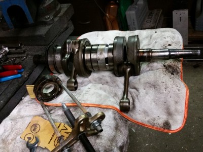

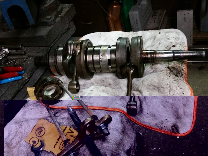

I guess its a good thing I got into the case. The mag bearing to a beating........all the others are excellent. Must have been run with bad water pump seal for a bit.

Finally had some time to work on it. Motor should be back together soon.

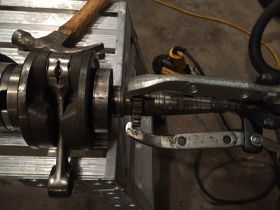

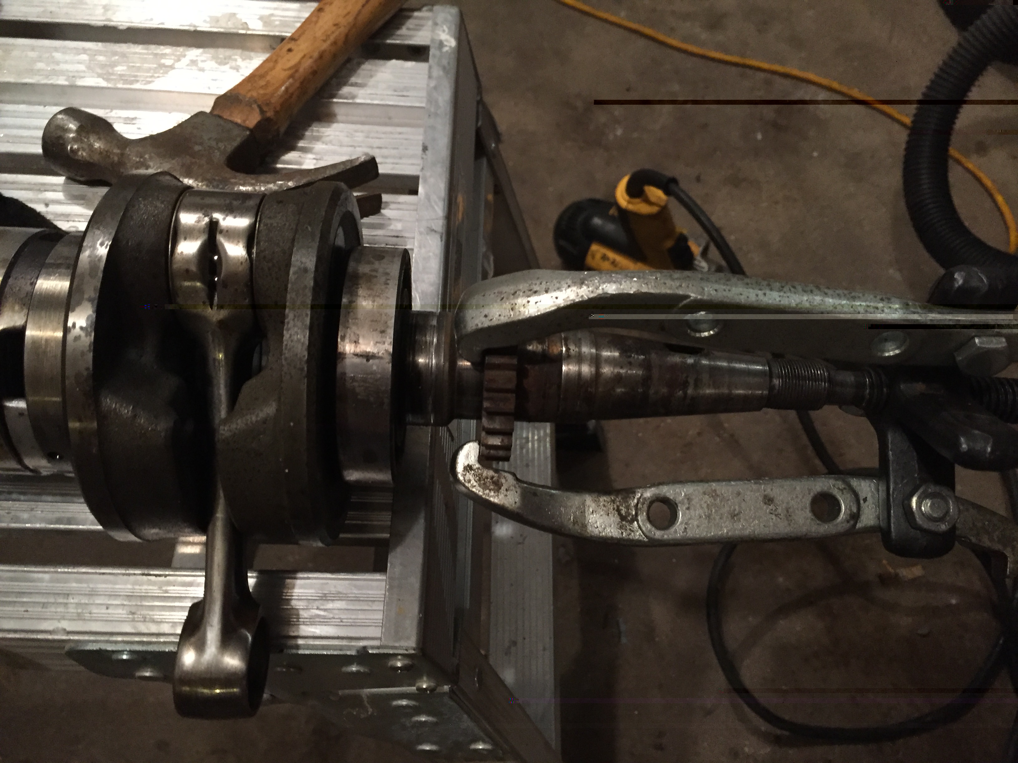

Just getting ready to pull my gear to change seals as well. Of course my puller isn't long enough...
What puller have you guys successfully used to pull that little SOB?

100's of them on ebay just a std bearing puller set. Look for a set that has a thin wall area that go behind the gear. My set was just tapered and did not work well. Your gonna need to get that gear real hot to pull it. At least that's how mine was, even then I couldn't get a grip on it and had to cut the gear off. good luck.killerklown wrote:Just getting ready to pull my gear to change seals as well. Of course my puller isn't long enough...

Be careful with the heat on that gear......to much will cause the crank to expand also making it not want to come off. I heat it just enough that it will slip off without a puller.

Finally got my gear pulled tonight. Of course the only puller I had here was too short, so I had to extend it. Wasn't as bad as I was planning, just took a little patience...
