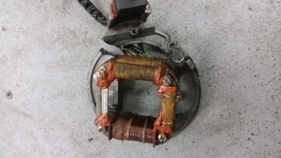

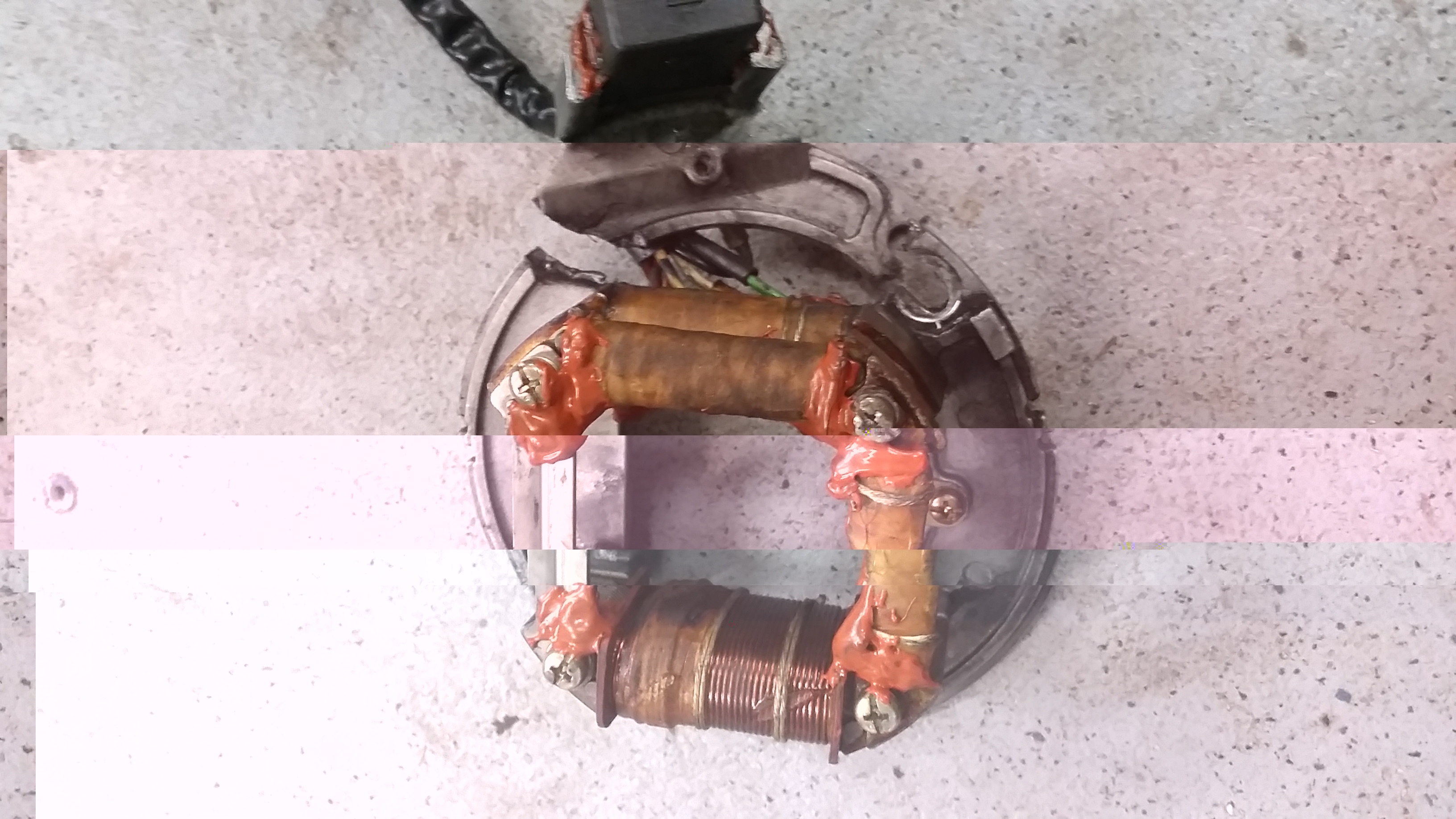

Good.. and bad news.
How in he heck does this happen?
