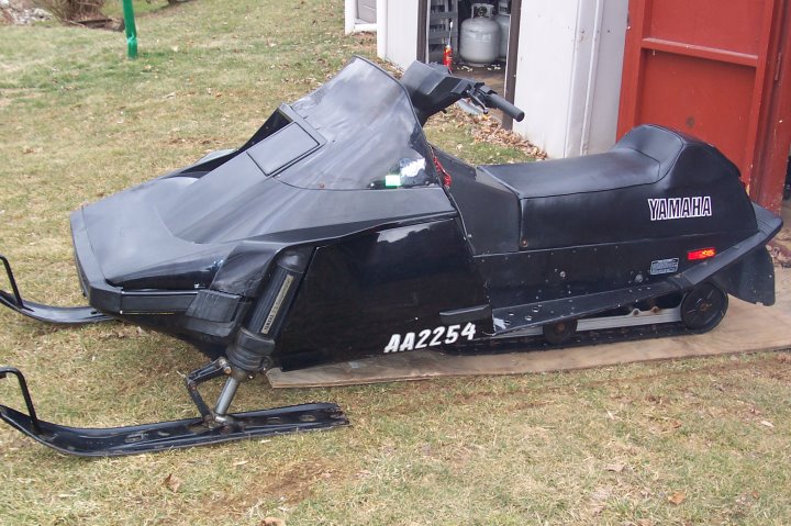

Has spark at the new plugs, compression and is getting fuel. It won't even fire with starting fluid in the jugs. Weird. Has always been reliable and fires on 2nd pull. After last thursday's storm and riding it bogged and stalled out. Fired back up and limped it into the garage.(bog). When I went to pull it the next day, the pull starter almost busted 2 fingers and was extremely difficult to pull. Pulls fine now. Checked PSI, 135+, changed plugs, good spark, getting fuel. I am baffled. Any thoughts would be appreciated.
