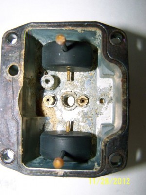

im new to the forum so need to be patient with me. i had bought an 83 540 vmax this year and in the process of restoring it. all fuel lines were rotted off and the shut off valves leaked. bypassed valves, and have oil pump disconnected. got it to run. will idle good. mid to full throttle just boggs down. just found out that the ports on the bottem of the bowls are to be connected to the ports on the side of the carb. runs alittle better but not rideable. found web site that shows 2 jets in the bottom of each bowl, as this machine had none. no idea if it needs them or even what size or if thats my problem. carbs are very clean also. any help would be greatly appreciated.

your probably going to have to post some pictures of your carbs so we can see if they are stock or off of something else

THERE SHOULD BE A POWER JET AND A MAIN JET IN THOSE BOWLS. 3:16 (yammie tony)

actually i just re read your post tony... i thought you were trying to say that all of the jets went in the bowl...
what your are trying to tell the OP is:
Someone probably took the the jets out of your carbs and never put them back. You most likely need all of the jets, including the ones (power and main) that screw into the float bowl

no tyler, i stated jets in bowl. SOMEBODY BLOCKED YOUR POWERJET OFF AND REMOVED BOTH MAIN JET AND POWER JET FROM BOWLS. THE MAIN JET IS THERE IN PICTURE 2. 3:16 (yammie tony)
Re: fuel issues
where are all them jets you stated. if that jet in the bottom of carb is the main jet do i need any in the bowls ? and i dont see where there is anything blocked off.
