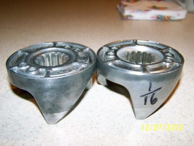

If you are going to run a 108 you have to have a secondary designed to work with it. You may be able to remove enough material from the backside of the stock secondary helix to allow it to open far to compensate for the difference in diameters but you will have to experiment.

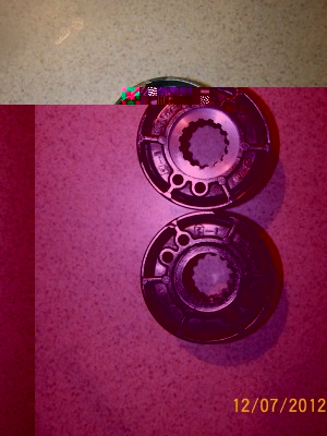

Helix cut 1/16" for use with a 108
