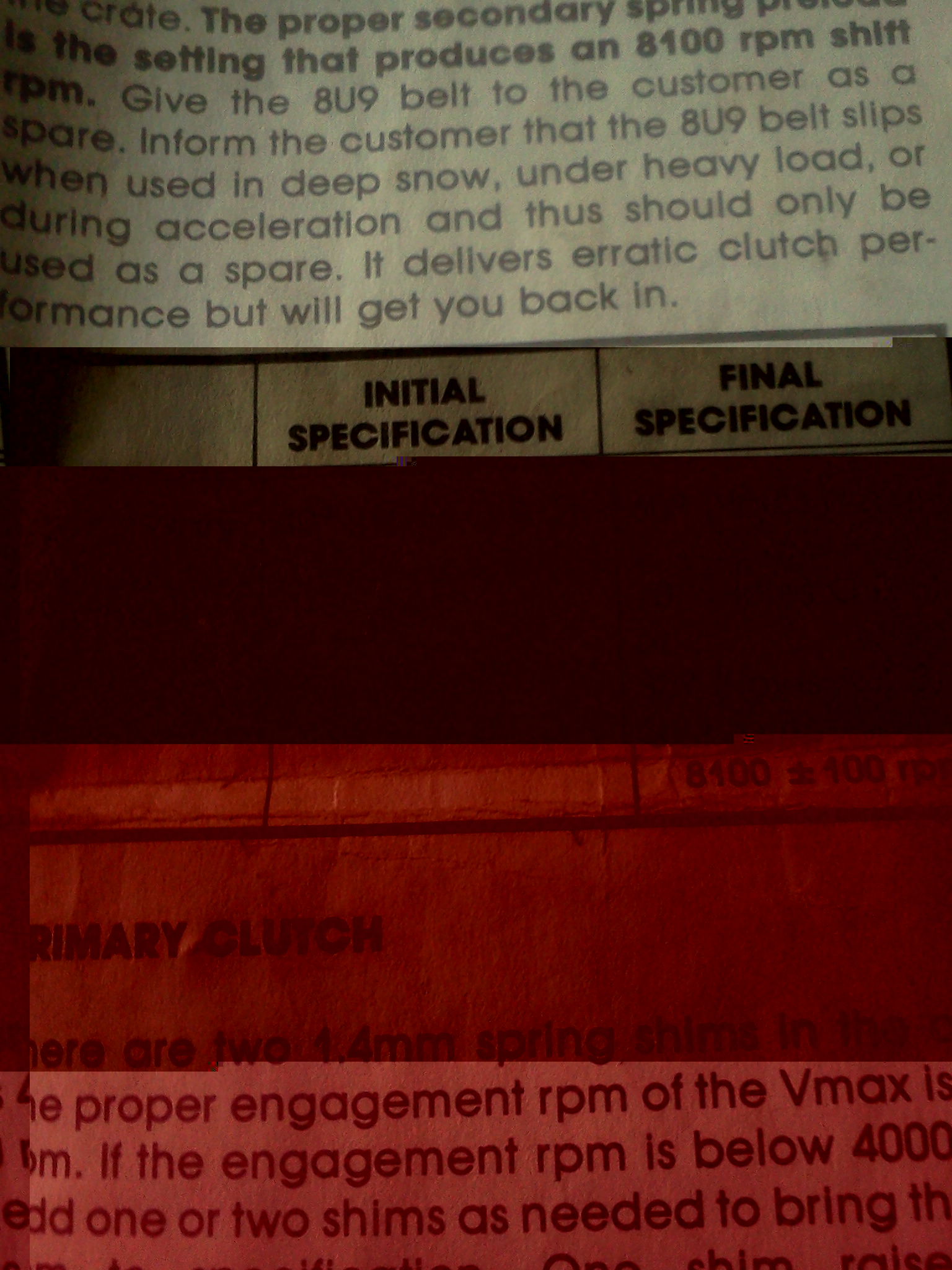

CRAZY JEFF. 1983 TECH MANUAL I HAVE SAYS B-2 @ 60 DEGREE WITH 8M6 BELT. THAN ITS SAYS STOCK SETTING (c-2) FOR LOW SNOW/ COLD ICE CONDITIONS. I AM GONNA TEST AND SEE. B-2 IS WHERE ITS GOING IF RPM IS LOW. 3:16 (yammie tony)
Re: SECONDARY SETTING. 3:16

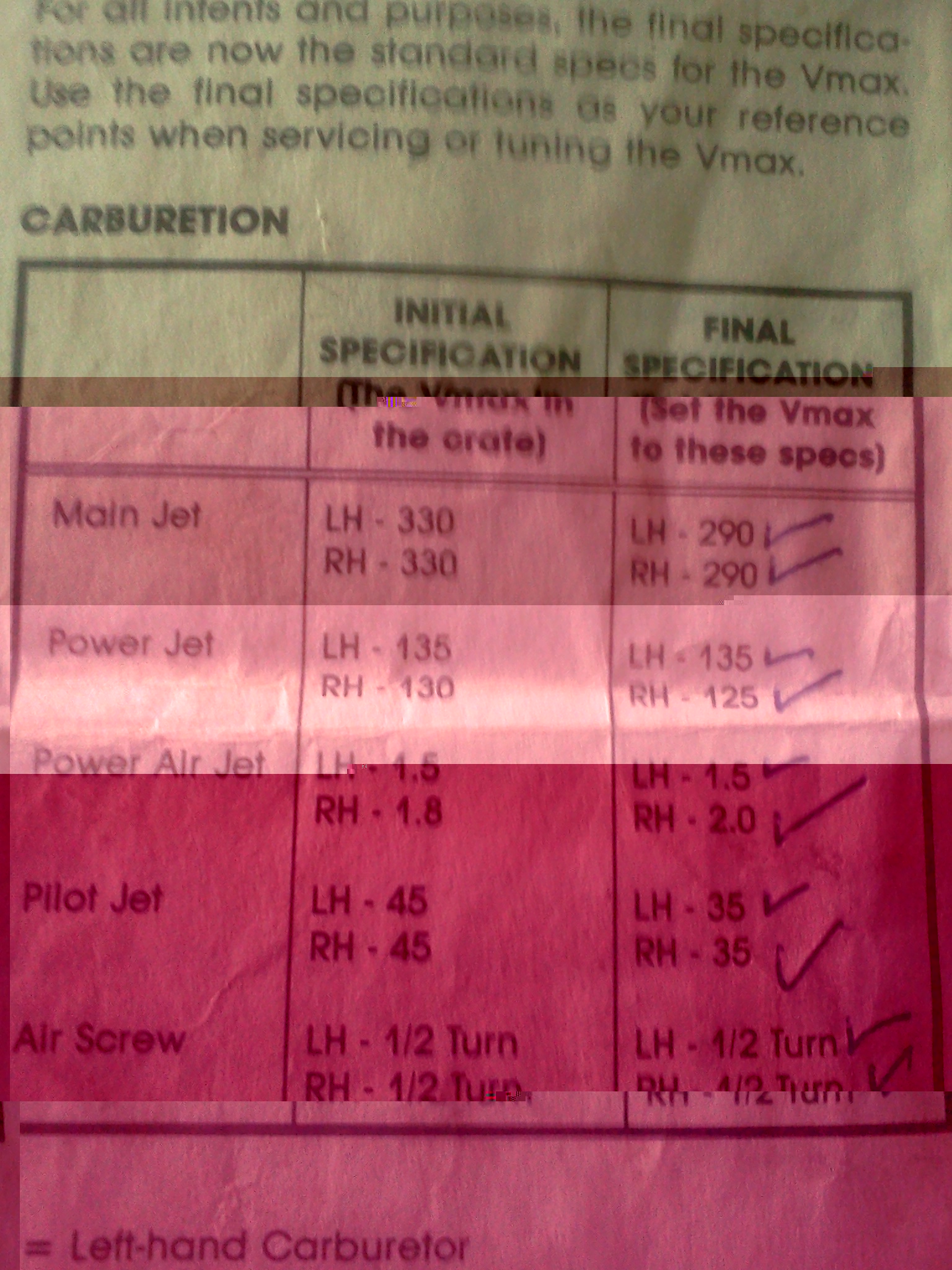

Tony You are right there is a lot of confusion on ALL the 83 Vmax specs, sounds like Yamaha tested right up to the last minute.
- Posts: 222
- Joined: Mon Mar 03, 2008 12:08 pm
also had several different jetting spec,s too. 3:16 (YAMMIE TONY)
That's what I mean just about everything is different..
