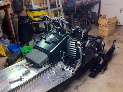

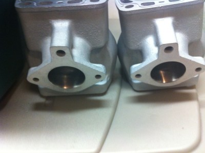

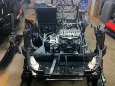

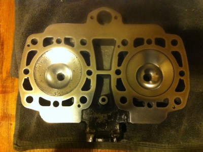

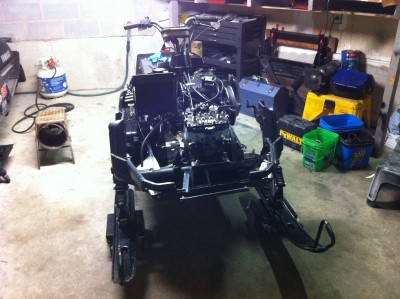

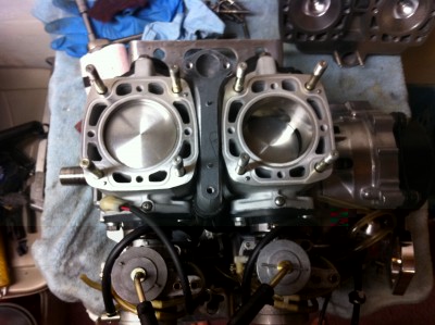

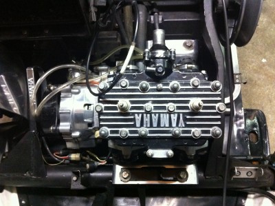

here are some pictures of my 81 srx that is almost finished. it has a freshly rebuild motor in it with all new gaskets, new cylinders, pistons, piston rings, brand new oil pump and new carbs and all new fuel line. i also polished the ports in the cylinders and also polished the manifolds. so here are some of the pics that i took.
i will put more up when its all finished.

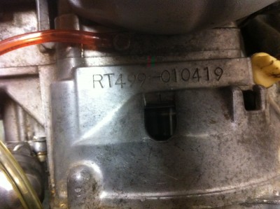

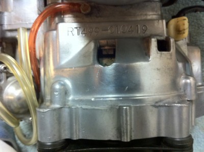

Should be interesting to se the numbers on the Cyls and Head. Same as the Motor number on the Oil Pump Cover?

SRX500F82 wrote:Should be interesting to se the numbers on the Cyls and Head. Same as the Motor number on the Oil Pump Cover?
the cyls are 8u9 same as the head and oil pump

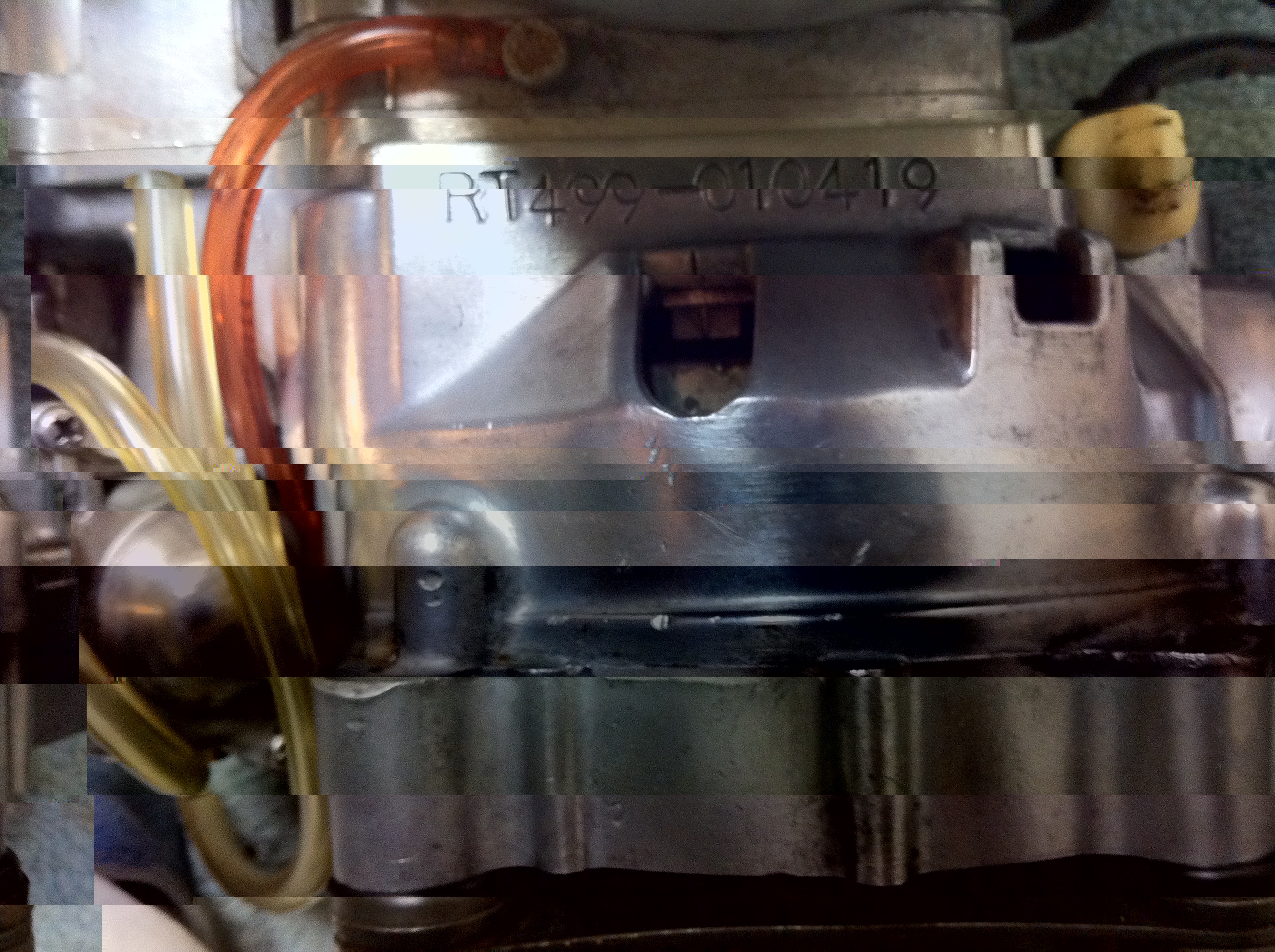

You have a Cover From a SRX 500 Motor does your Cassie Number Match Up?
no but it does have the srx 500 crank in it with the vmax 540 cyls and 540 head oil pump on the motor

WOW i wouldnt be using that bottom end that is worth some $$$$$$$$$$$$$$$$$, how did you polish up the motor so nice?? and clean up so nice...

chrisrider63 wrote:WOW i wouldnt be using that bottom end that is worth some $$$$$$$$$$$$$$$$$, how did you polish up the motor so nice?? and clean up so nice...
thank you i can tell you its alot of work. and all done by hand i used steel wool and steel wool pad and the polish that i used is called Autosol Metal Polish works great its alot of work polishing up the motor.

The Prefix Number RT499 on the Cover. Or if you name it as Pump Drive - Gear indicate the 499cc 8R9 SRX 500 Motor.
as Chrisrider63 told you be careful with the SRX Crank. Very Very hard to find spare parts for it if you blow it up :cry: :wink:
yes i know. i got this motor when i bought my other srx off a guy that had this motor in it and he blow it up.
and did some 81 srx come with the 500 motor in it?

No that RT499 bottom end is a rare collectors item and i would not be using it as only there are 15 srx 500's out there and only a few people from this site have one.
