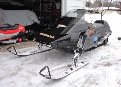

here is the sled after cleaning it up. I bought a new windshield and still needs a seat cover but it has potential if I can get it running right.

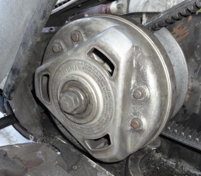

here is a picture of the clutch- can someone tell me what puller I'll need to get it off?

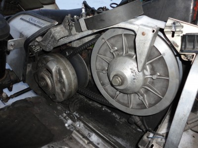

I had some time to work on the Vmax this weekend and a I quickly found part of the reason for lack of performance- the belt was wasted and I cant believe it moved the sled as well as it did.
I also found what appears to be evidence of an exploded clutch- the frame behind the clutch is all chewed up.
I got the old YP clutch off and didnt even need a puller- it just slid right off.
I bought a replacement clutch off a supposedly good running '86 - its a Comet 108c.
I had to order a new retainer bolt and washer but is there supposed to be a spacer/washer on the back side of the clutch before I slide it on the shaft?
