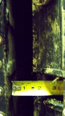

What is the max height of a track lug,that we can use, without going to smaller drivers, and are we talkin from the top of the track to the lug top, or from the backside?

One line to each fuel pump ( two pumps and two lines are a way over engineering feat by Yamaha). "What is the max height of a track lug" Most go with a .750 and some older style but, newer than than the Vmax tracks were .875"

I found a nice looking track in a pile I had, looks like 1 in lugs but haven't measure it yet, sure wasn't getting this thing to hook up last year. If it is 1 in, has anyone found smaller drivers that will fit?

I dont see why you couldnt squeak a 1 inch thru there ? is it because of the tunnel protectors? if u were to bottom out the lugs would rub the exchanger?

Bob, going non power jet is a whole new game.... I know somewhere I should have jetting recommendations for non PJ 540's so, I will look later tonight. Track lug depends on it you want to stud and if not of course you can get away with higher lugs and not hit.
