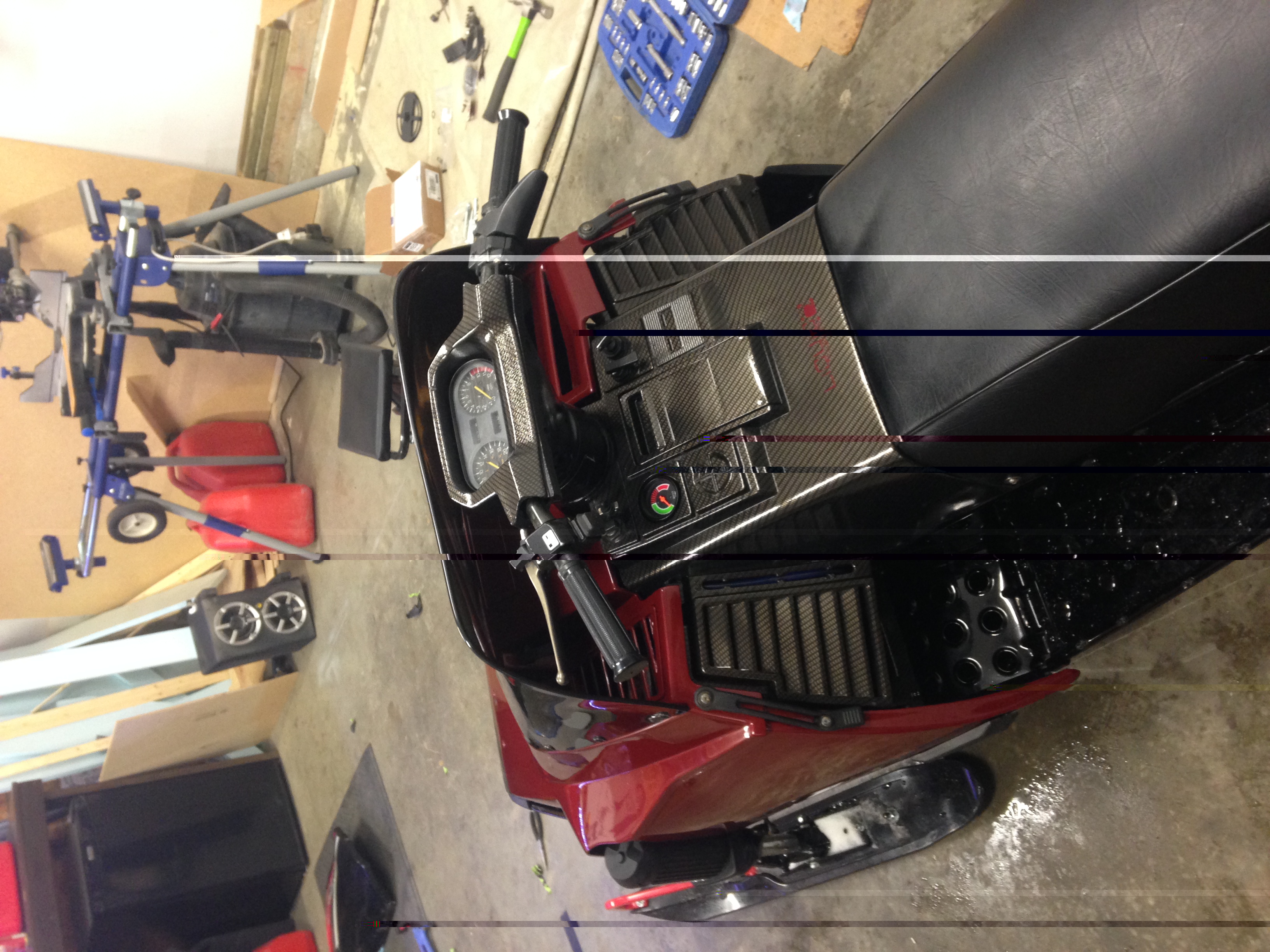

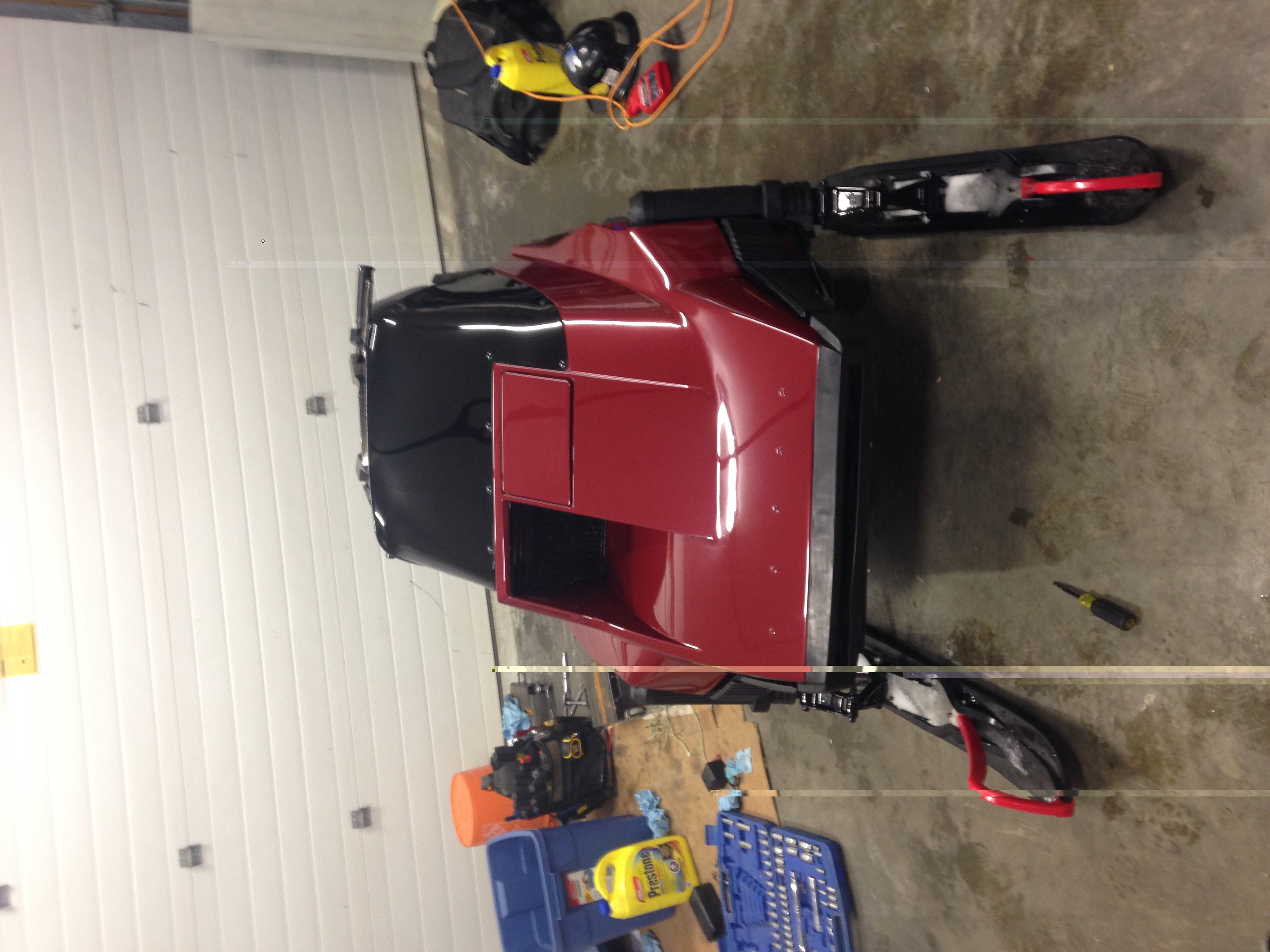

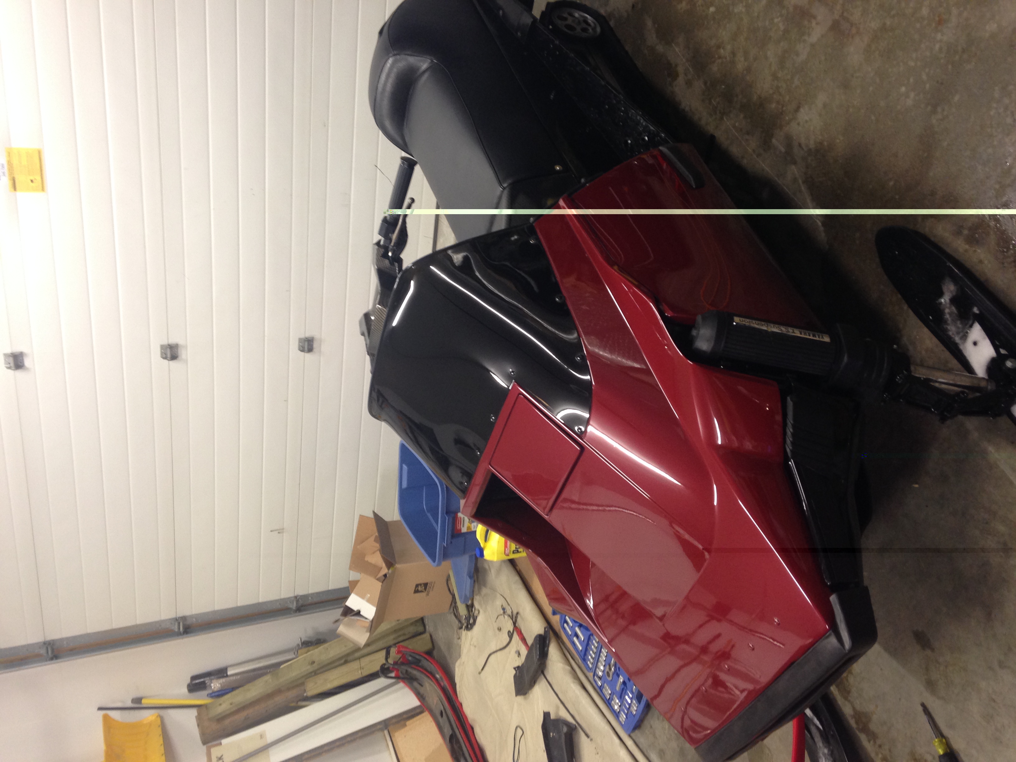

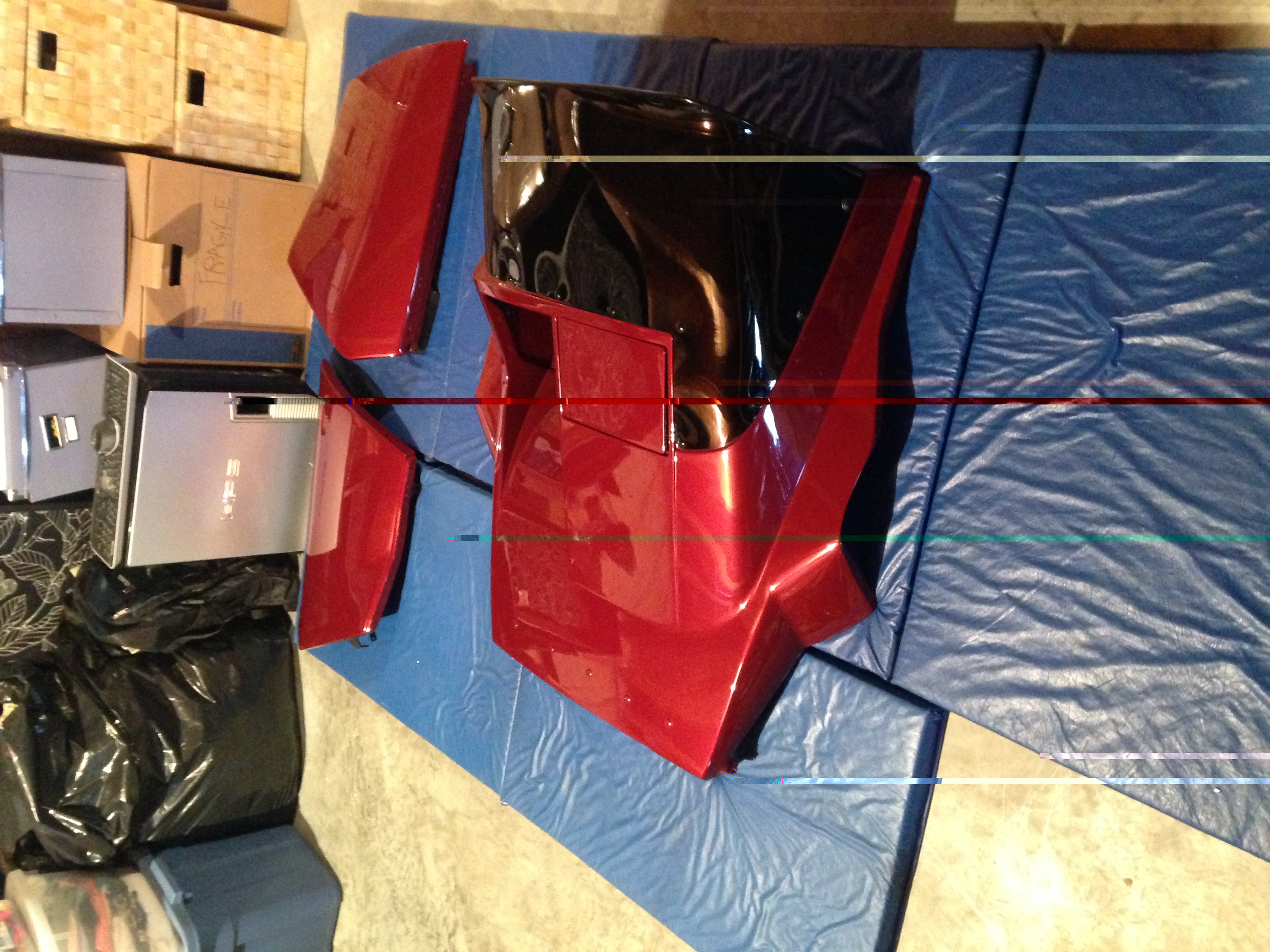

(I'll post pics of the Sexy-Max if I can figure out how.)

Looks nice. Sorry I can't help you with a set up for what you have, my engine is not stock. What I will say is if your buying new, most of my sleds have always had Comet 102 or 108. When I finished the new engine for the V Max last year I used a Polaris p85. So far so good, but I was sick and tired of bushings being beat out of the Comets in a season

Kyle, Sharp looking sled, I see you like to detail ! Either way, If you're staying with the 102 or going to the 108 I'd run the A3's and the purple #207758A spring. If you go with the 108/wide belt you need to either machine the secondary helix or go to a different secondary in order to gain any benefit.
